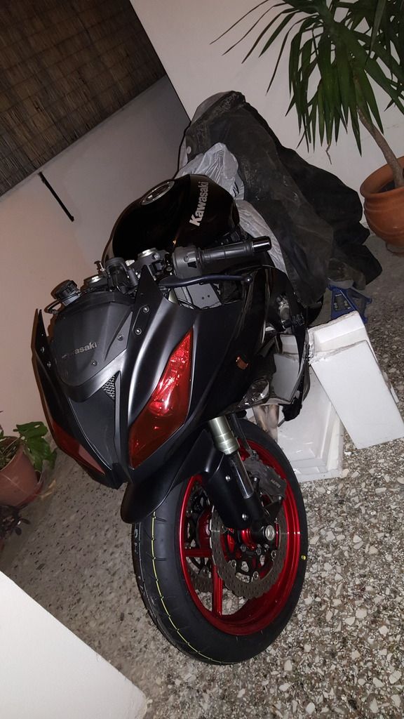

Complete tear down,
Frame good as new and reinstalled.
Sent front forks, rear suspension and stock ohlins steering damper to get some maintenance. Complete service kits.
Installing some parts while waiting for other to arrive in mail..
Installed subframe etc
Got an OEM 2013 undertail, going for the 2013 look zx6r
Also got my forks back from service.

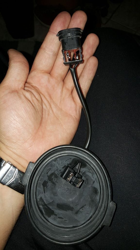

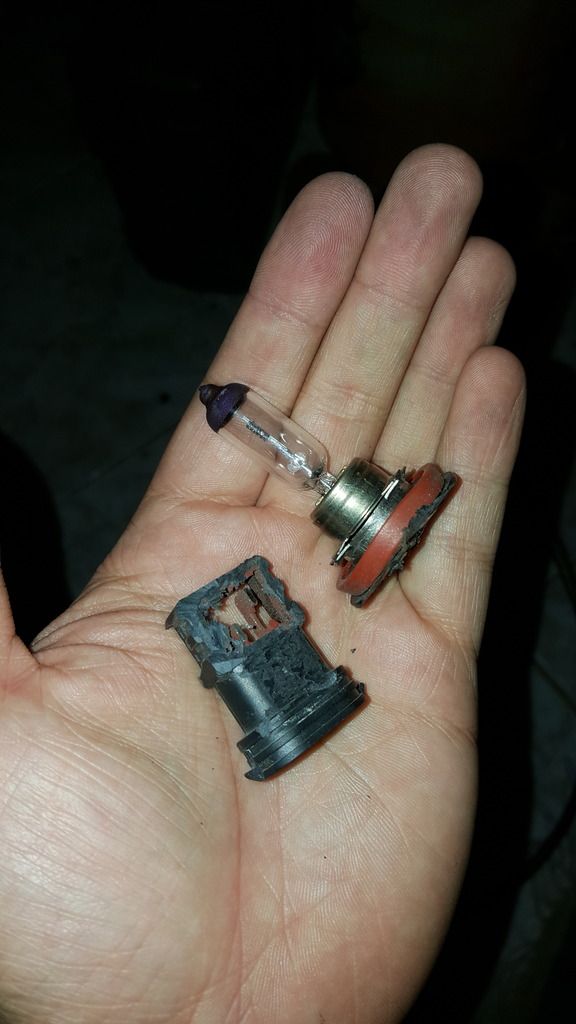

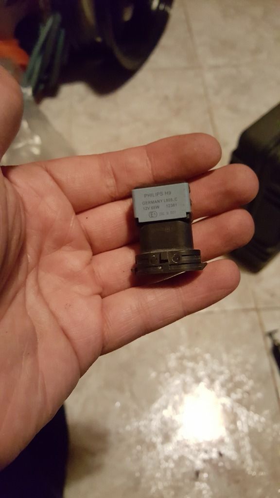

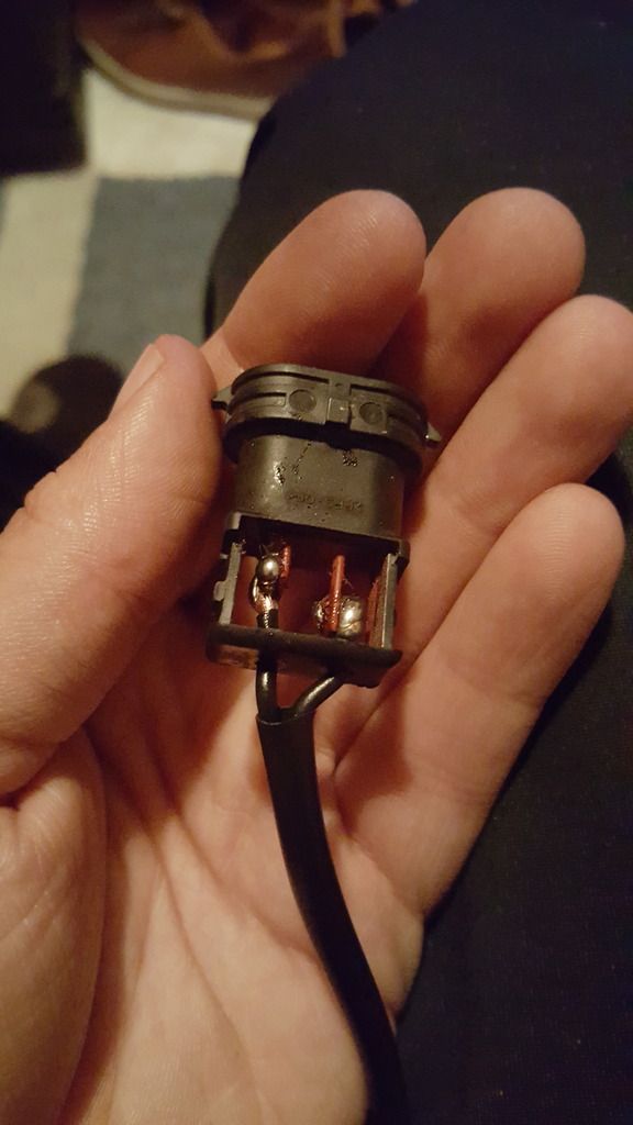

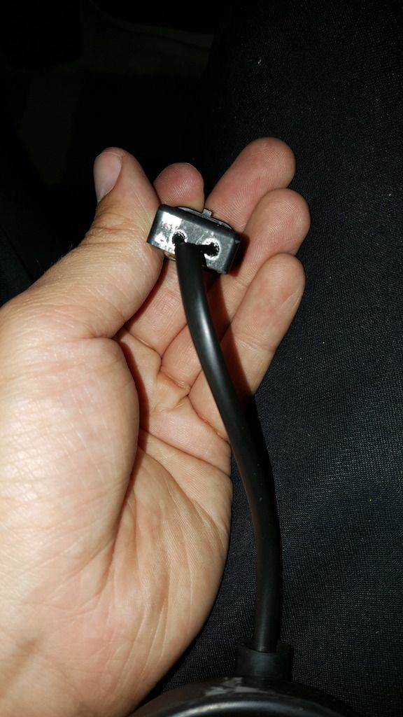

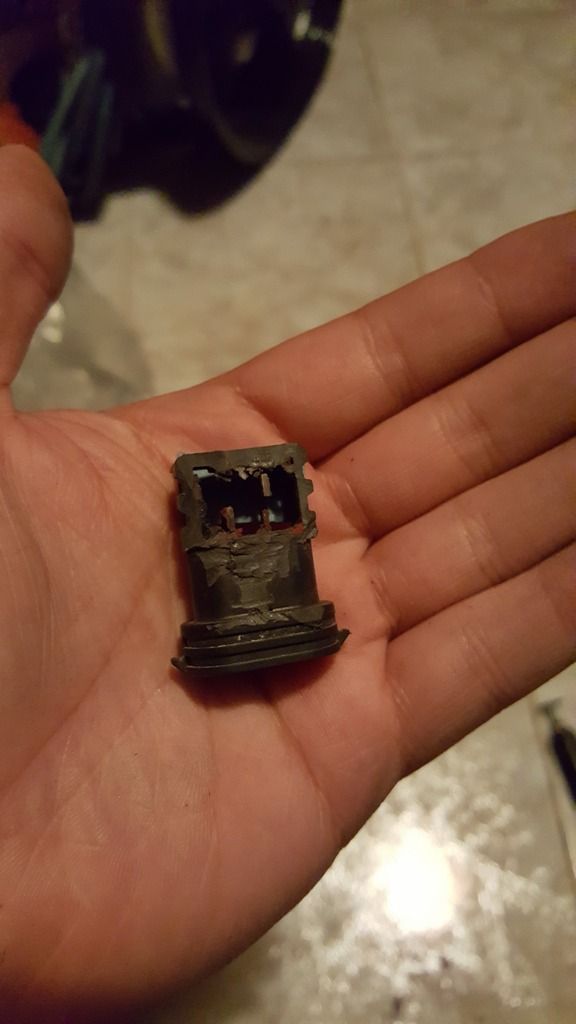

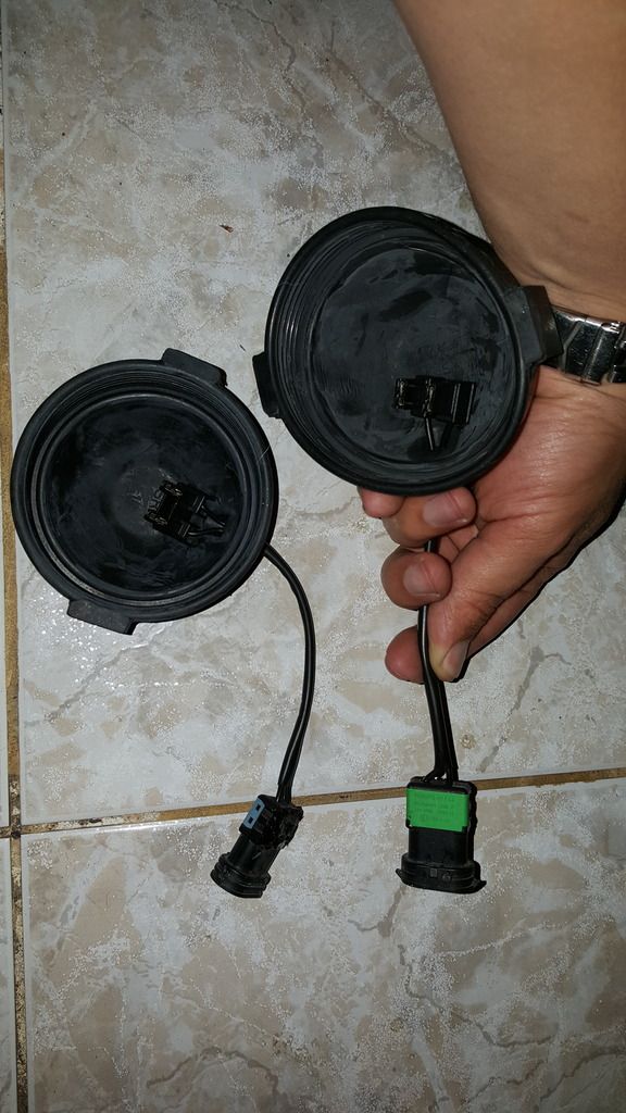

The 2013 headlight uses two H7 bulbs while my harness has an H9 and an H11 connector. I don't like cutting the OEM wiring harness and couldn't source any H11/H9 to H7 converters so i made my own.
The victim
Dremmel time!
Leftovers (managed to drop and brake both of them!! lol)
Bought the OEM connectors for the 2013 headlight from the stealership, removed the connectors to the wiring harness and...
Filled them up with black silicon later,
Result

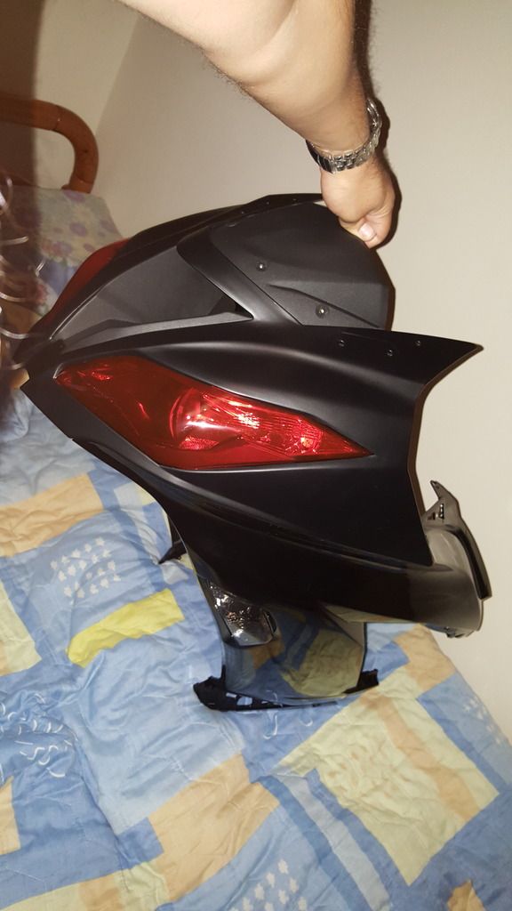

Received my Auctmarts fairings
Auctmarts windscreen
Auctmarts bolt set (used many of them, but even though the box was bike specific, most had no place to go)
Fairing kit (except from tail side fairings that got lost somewhere on the way...)

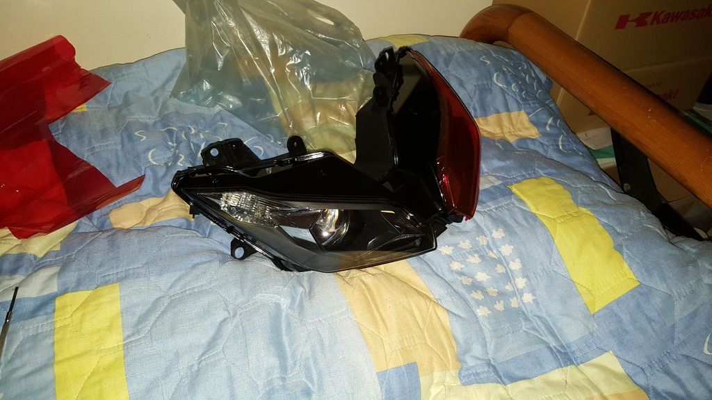

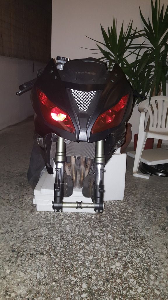

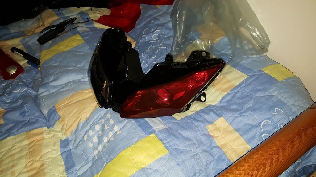

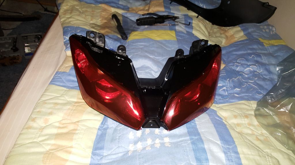

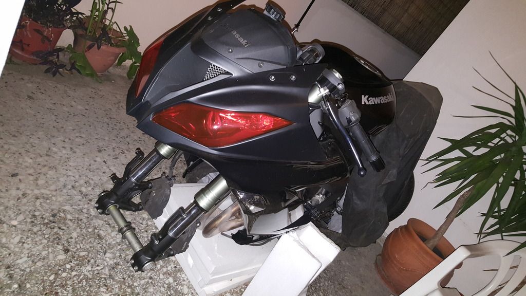

Received headlight and red tint....I won't say "headlight" tint....Because even though it looks bad ass....It shines red...I had purple headlight tint on my old bike and it shined white.Anyway...
Used some alloy mess at the ram air.Had completely forgotten about it.I thought it would be deep/not visible so i didn't paint it. Anyway....

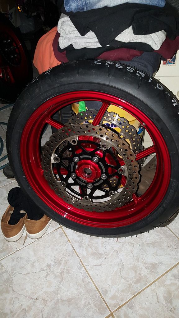

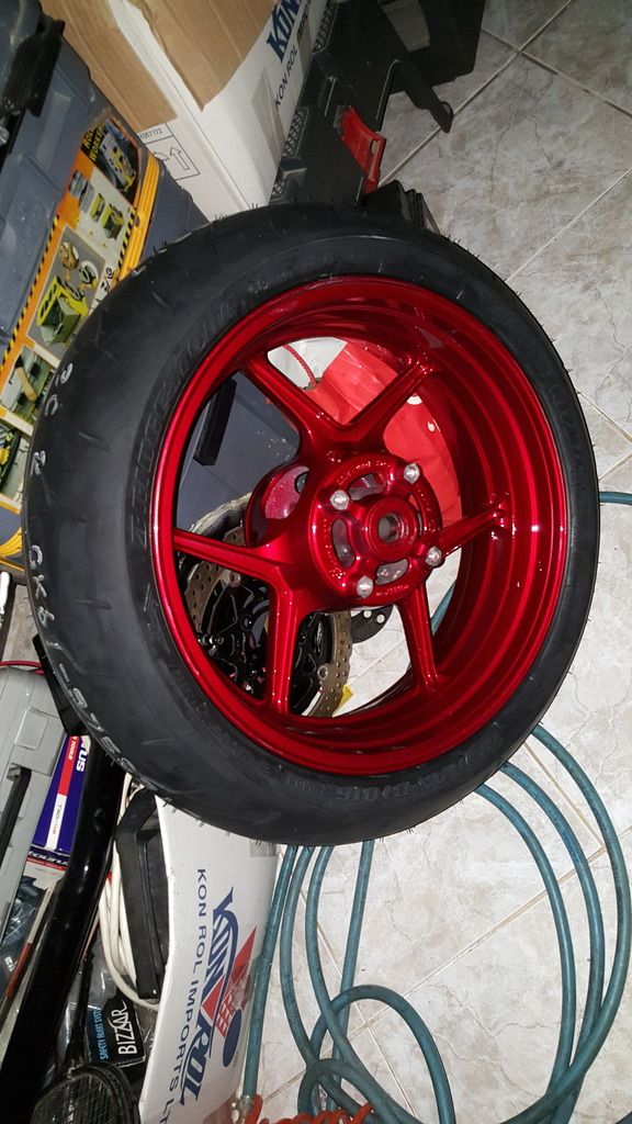

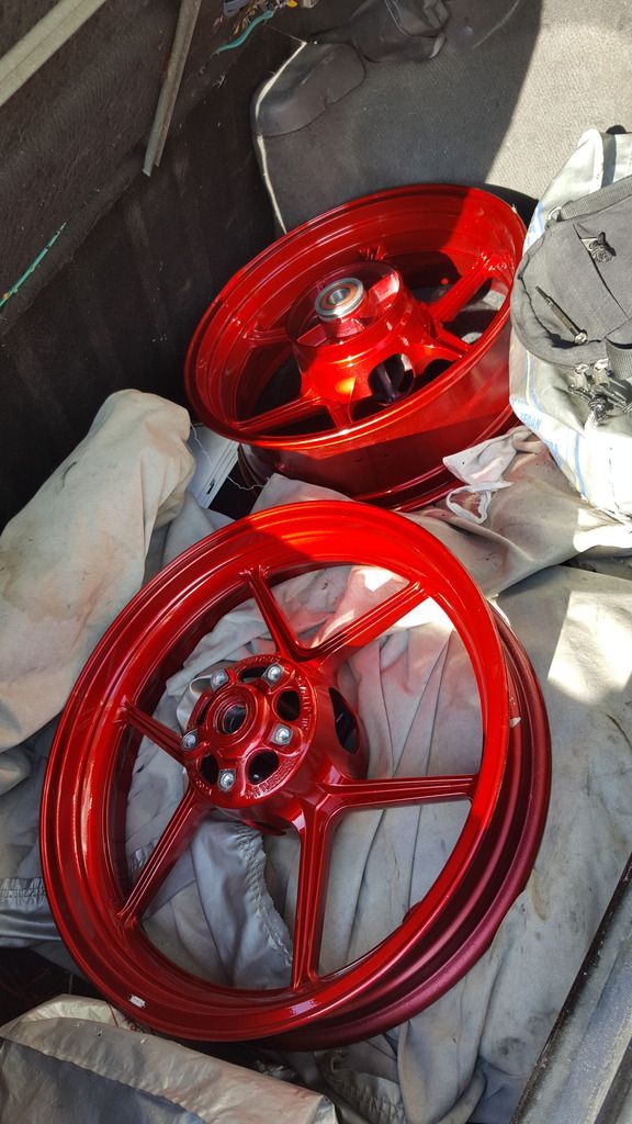

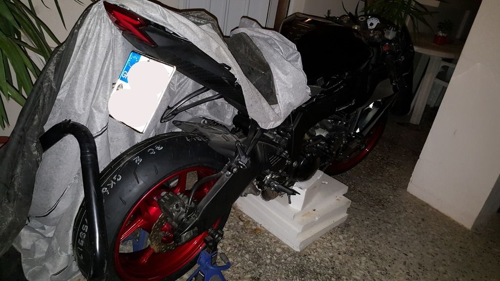

Received my new front wheel.
Had both of them powdercoated candy red
And fitted some new BT16
Chinese intergated taillight fitted(not recommended, turn signals barely visible, if you are on the brakes not visible for sure)
Also, since the connector to the bikes' harness is different,i removed the taillights' connector and got the wires in the bikes' connector.Then i wrapped them up with electrical tape.

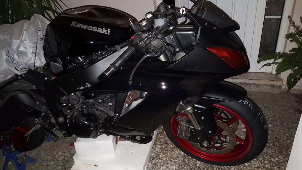

Coming along...
I like the way the rear brake fluid res was on the '09 so in order to keep it that way...
How on earth did this get a hole like this?!!It's the front brake fluid res to MC hose.
