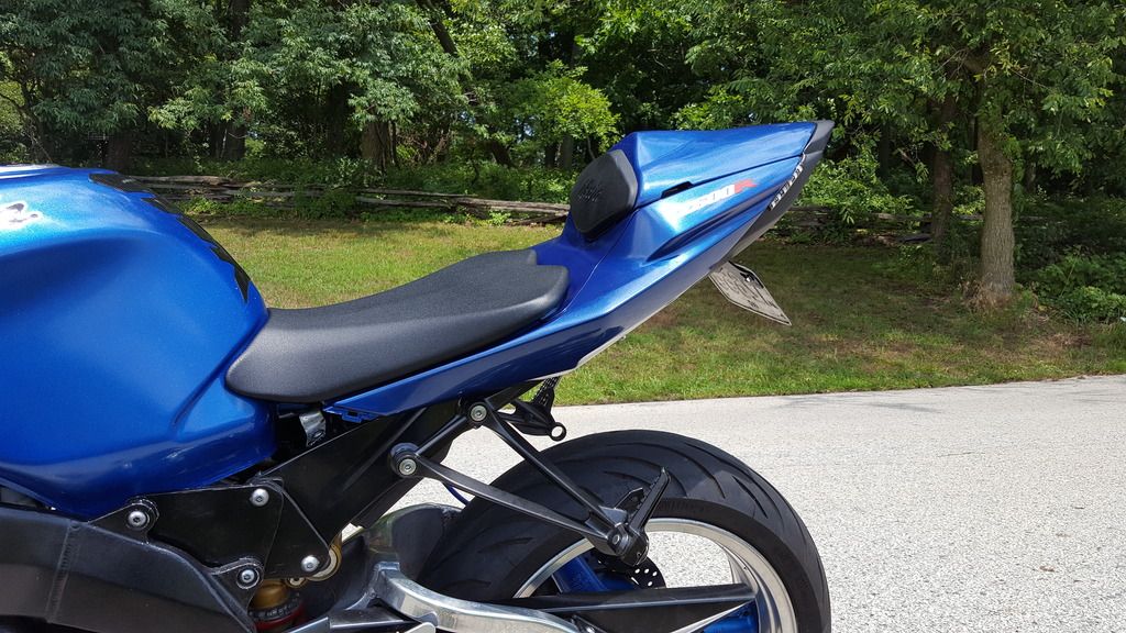

Don't know how I didn't see this sooner. That's a nice find! Looks like you got a nice deal too. Since you didn't pay anything to buy it that means there's more money to dump into it :devious
If you want to do a tail swap it'll be easy to find some inspiration. The G and J are a nice model to swap a lot of parts. I've got an 09 tail on my 2002. It was a lot of work, but from what I've heard and seen other swaps should be easier. It'll take some work though, but the results are well worth it
Yours looks good! I can definitely see a tail swap in the future. I'm focused on getting it back on the road first though. Getting a full set of '01 plastics for $199 shipped made me decide to go ahead and do that rather than piecing plastics together with a more updated tail.
