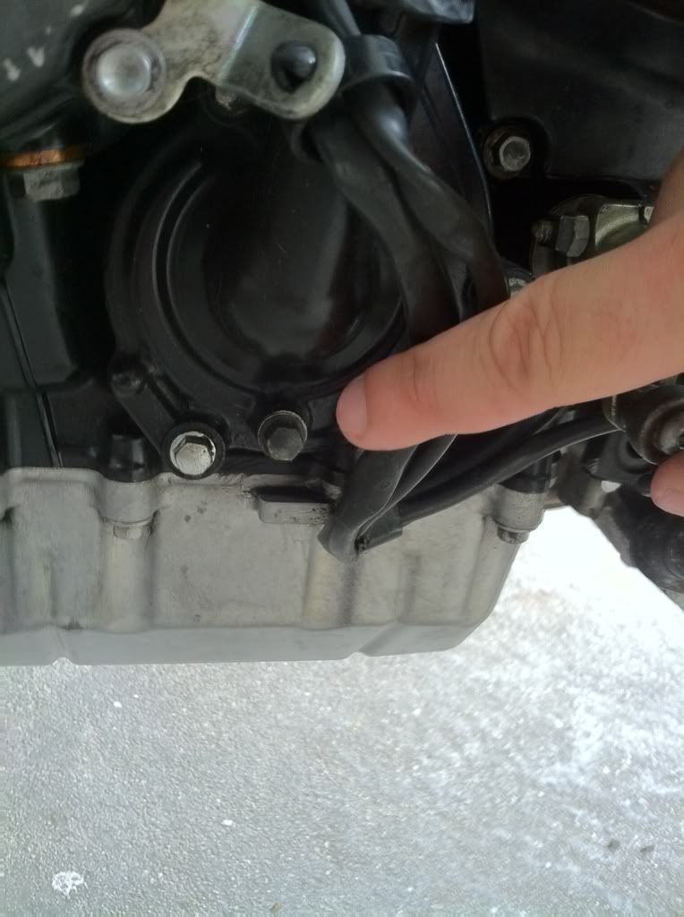

Now once these two have been removed there are two drain bolts on the block one is behind the header and the other one is on the water pump cover...
This bolt requires a 10mm socket
And this one requires a 8mm socket. (I nylon tied the wires in front of it to the shifter pedal so it would not splash me.)

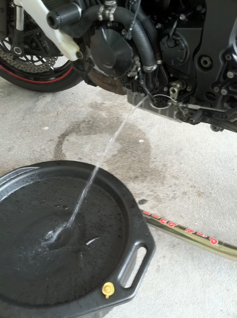

Remove the lower bolt first until it completely drains...
Then the upper bolt behind the header also till it completely drains...
Then at the bottom of the reserve tank remove this hose and drain it...
Once all is drained fill the radiator with distilled water only and pour it very slowly not to trap bubbles. (I used a small funnel I had that kept everything clean.) Also fill the reserve tank to the fill line.
Now put the radiator and reserve tank cap back on and turn on the bike. Run it until the fan turns on and shuts off. Once the fan shuts off, shut off the bike. Let it cool and drain it once again. I did this about four times until the last time the water came out looking like this...
Now she is clean .
