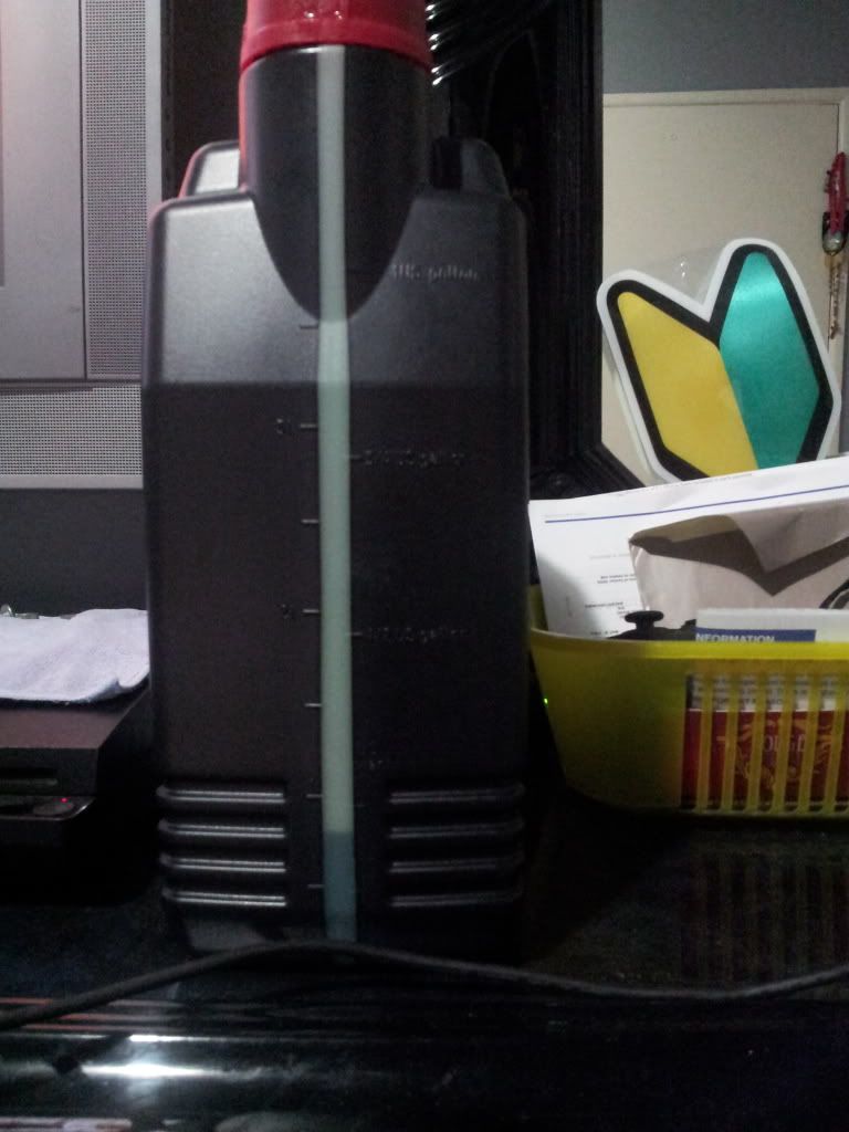

in the end I was left with this much oil
I couldnt accurately gauge the oil level thru the sight glass since I cant get the bike leveled nd get down on one knee to check the oil
But tomorrow ima get some help to really gauge the oil
Wat do u guys think based on from Wats left in the jug, too much or too little oil left in the jug
Any advice/critique is well welcomed!

with the oil as long as you're 31/4 to 31/2 or more out of that gallon you should be good. the manual says 3.8 on a change. i myself usually go dam near the full 4 because i use a larger car filter that fits on.

FWIW, you shouldn't clean O/X ring chains with WD40. Google and read about why you shouldn't do it. Clean with kerosene or an approved cleaner for sealed rubber ring chains, then "lube" to keep out debris.
Hmmm ima look into this, I even asked the guys at the shop if that would be Koo nd they said yea, next time ill just but the motul chain clean spray. Thanks
