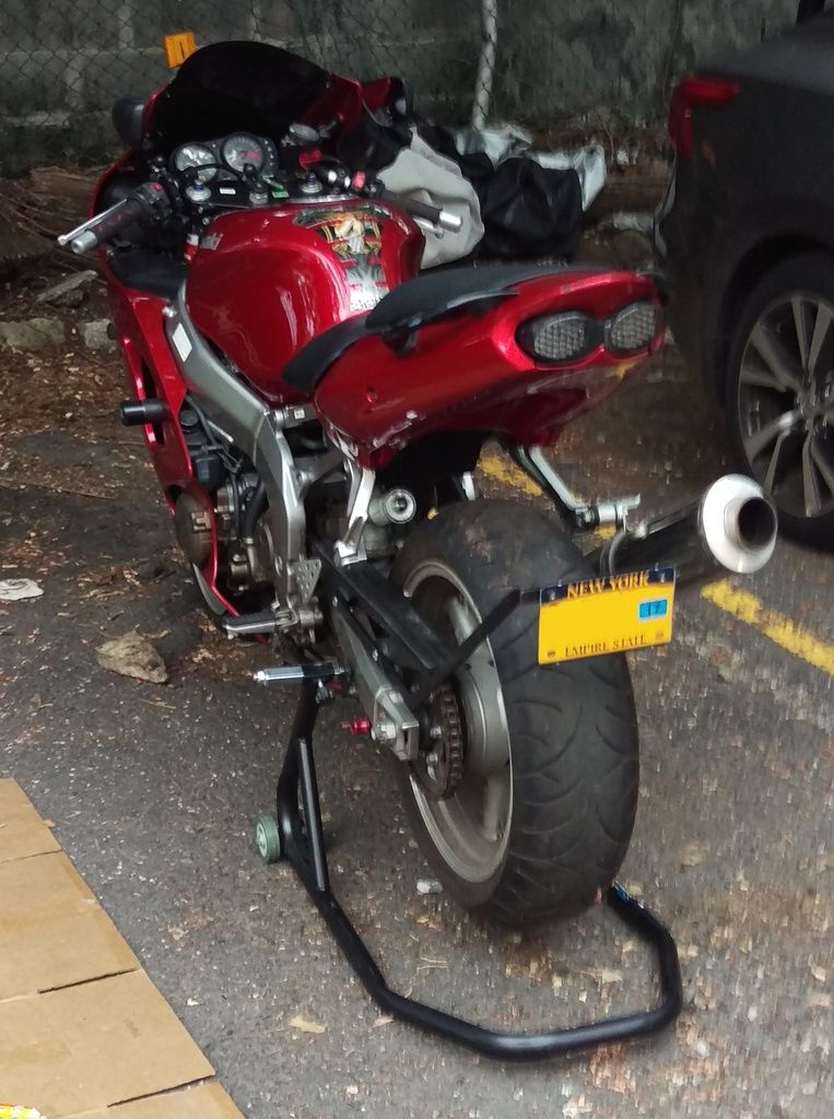

hello everyone my name is slick (s2ik).
I'm a new rider (2000 miles in) and I own a 2007 Kawasaki ZZR600.
While looking for parts I've learned that she is the same as the 2000-2002 zx6r.
At first I didn't understand why an 07 had a carburetor but i see what Kawasaki did...
so i have a little background in electrical and restoration(railroad interlocking machines) it's what I do for a living but this ZZR has been kicking my but.
After my last ride she has not been starting, she cranks but wont start so i was going with easy stuff first...fuel, battery,engine cut off switch, and kickstand switch and all was working as designed... then i thought of what it needs to run fuel, air and spark.
so after downloading the service manual I have been checking systematically, she has fuel and air but no spark.
she has no spark on all four spark plugs so I put new ones and still nothing.
the stick coils look good but I bought used ones to double check (could be bad too)
the crankshaft position sensor passed the bench test...
I have no idea how to check the coil ignitor leading me to the forums to see if I'm missing something, I also bought a used one to play with...
so i plan on doing a few write ups with pictures as I mess around with my zzr, I've also done a few simple mods I'd like to share...
I mean that's what the forums are for right... to share, learn and exchange information..
