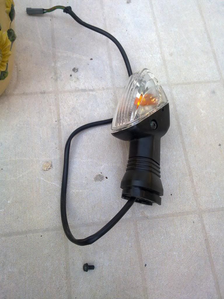

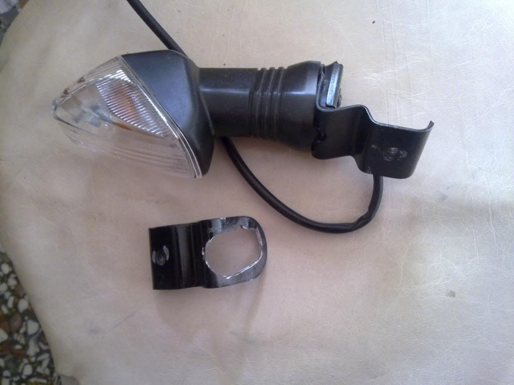

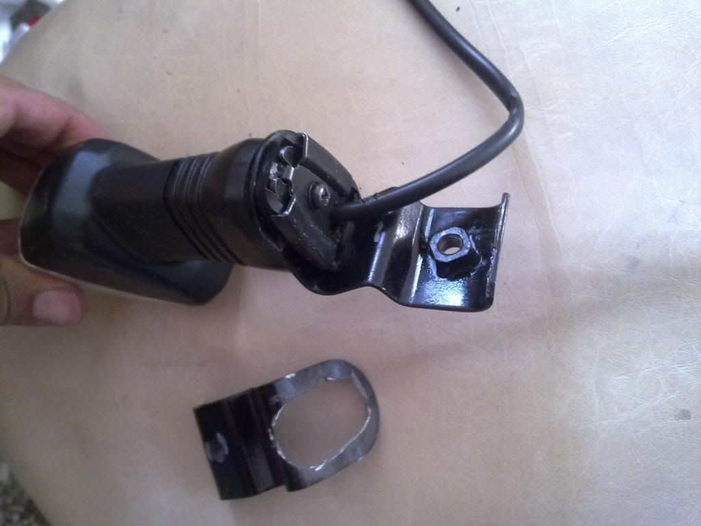

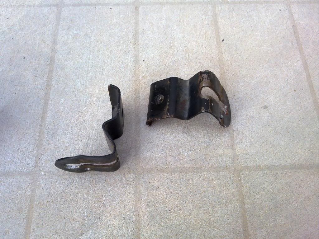

Made some brackets to mount the rear oem turn signals.
This used to be that piece of metal that holds the license plate on stock rear fender.After some cutting and bending.
The oem rear indicators

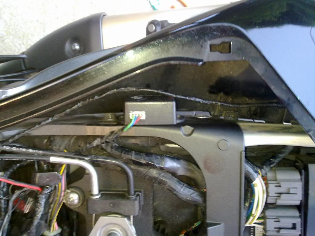

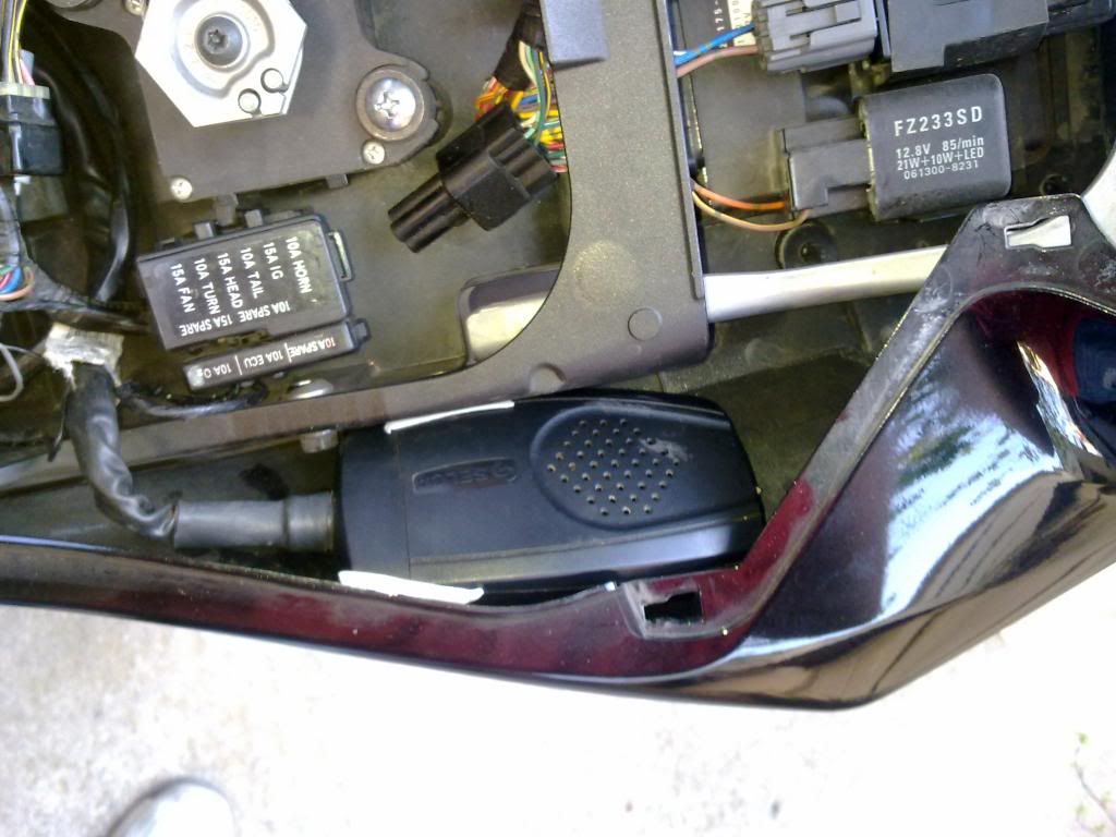

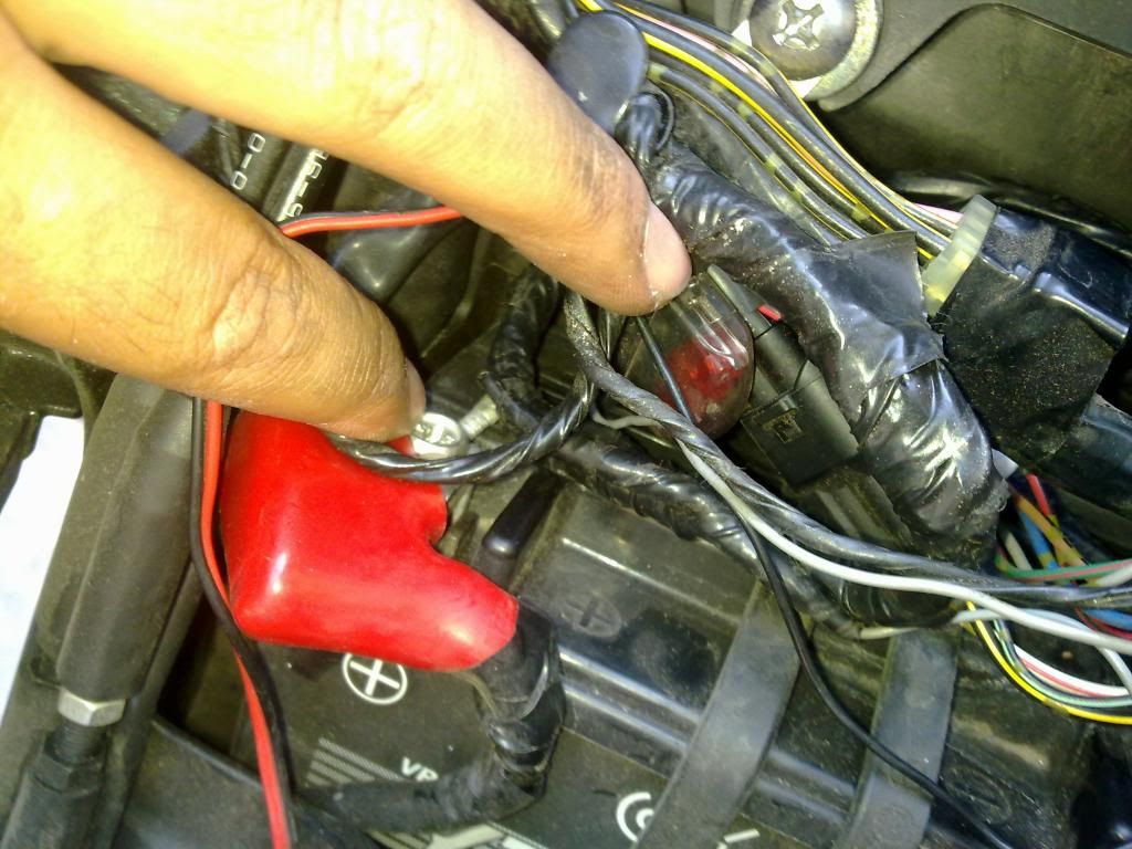

Next: I reinstalled my Selca alarm.I had this on both my previous bikes.

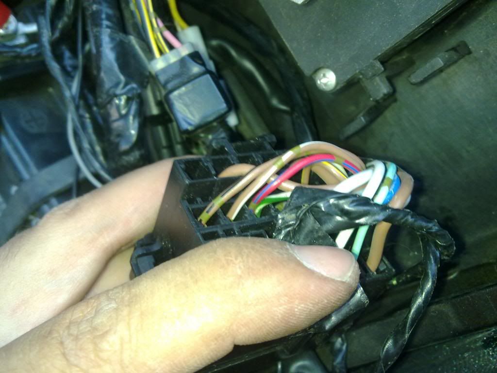

Slightly stripped the rear indicator wires, not the black/yellow, the other one.There is one wire coming from the alarm,for both left and right.

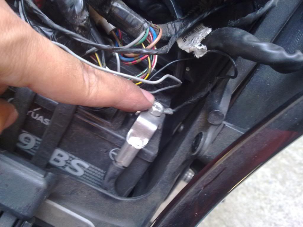

Wire to battery negative
Wire to battery positive(fused)
Alarm main unit with siren
Tilt module

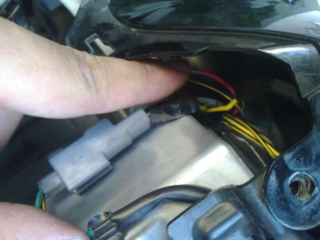

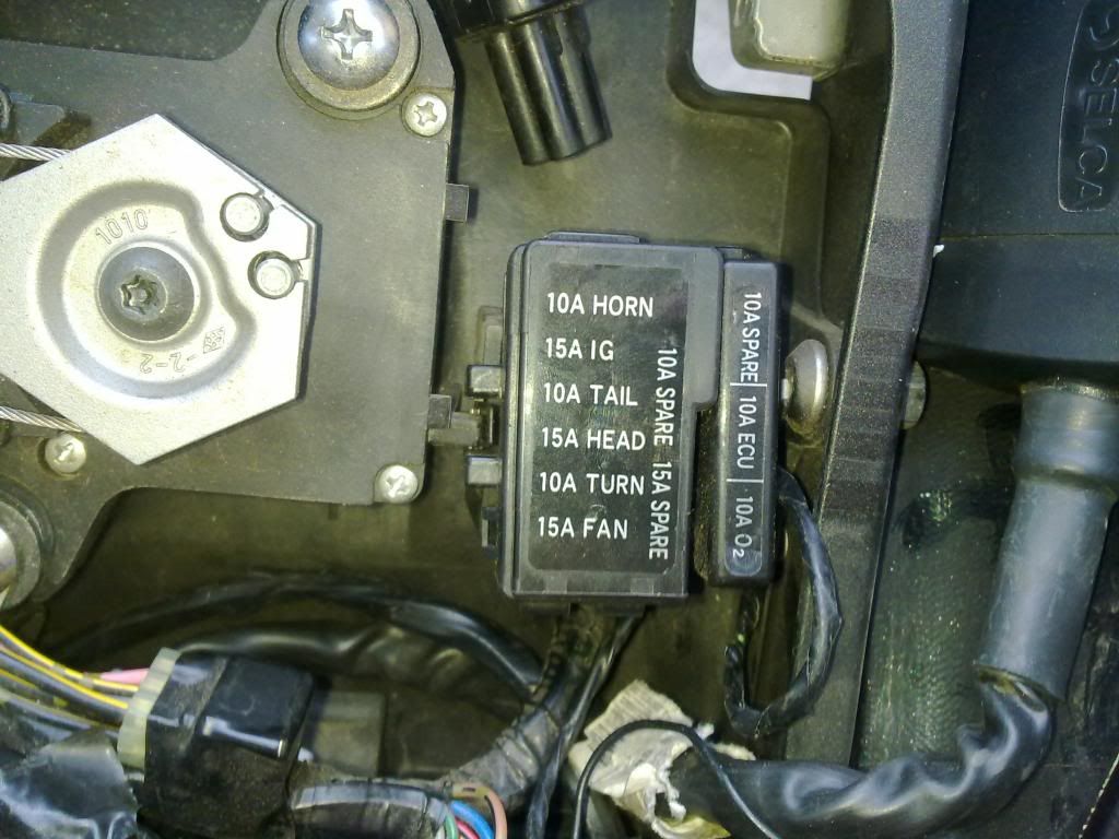

And one wire to anything that powers when key is turned,i used the taillight.
Alarm wire is the white/green one.3rd fuse from left.
Tail:3rd fuse from top
And now i got an alarm again.

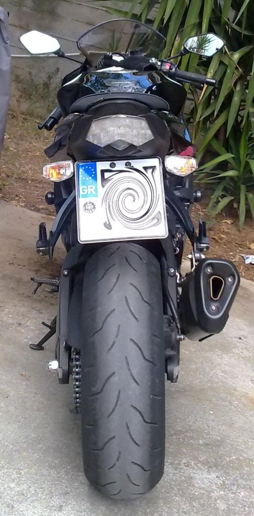

And this is how it looks with the diy rear oem indicator mounts
